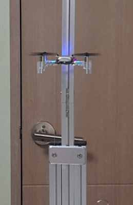

When I move up throttle, I can see that my CF 2.0 is not hovering with a little bit roll slope.
I make a test rig for testing the hovering.
How do I fix it?
Please, watch my pictures.

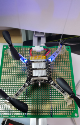

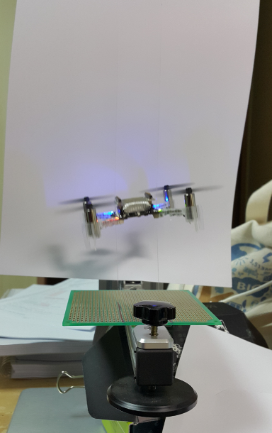

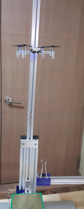

Hi! Arnaud,
Thanks for your information. From your instruction, I get a successful result. I modify roll trim from 0 to -1.8.
Pics are my result.
Do you think it seems right results?
Pics are my result.
