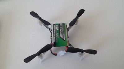

We are working on Crazyflie 2.0 platforms to develop few applications. We find flight endurance is low with the existing 240mAh Lipo battery weighing 7 grams. We plan to upgrade to 500mAh weighing (12 to 15 grams) for increasing the endurance by 2-3 minutes.
1. Can a 500mAh battery weighing 14 grams be mounted on a quadcopter, or is it too large/heavy?
2. Will it increase the flight endurance?
3. Wandering if I can use a 20C/25C discharge rate battery instead of 15C
I have screened few sellers for purchasing Lithium polymer (Lipo) battery which outputs 3.7V at 500mAh with 15C discharge rate, weighing ~12 to 14 grams.

Sure you can switch to a bigger battery and if flight performance isn't crucial you can go quite big. We tried with a 750mAh battery and got about 16min hover time. This battery has no protection circuit (PCM) so it needs to be handled with more care. Please see one of the graphs in this blog post for an estimate flight time calculation depending on battery capacity.
What will be limiting is fitting it on the board and inside the propellers. Also make sure the battery connector polarity is correct.

LiPo batteries are dangerous, full stop. The protection circuit is used to prevent over or undercharge situations on the battery. Both can lead to unrecoverable damage to the battery, and spontaneous combustion or explosion. Never ever leave a LiPo battery charging unattended. Without PCM you must watch the battery voltage very carefully. Buy a LiPo bag to charge in to help prevent against damage if the battery starts to overheat. Remove it from the charger and put in a safe place away from all flammibles if the battery starts to bulge.Cyientist wrote:That's great! Thank you very much Tobias, we will have a lot more flight time.

It think it is a lot easier to get a higher capacity 1 cell LiPo then putting two in parallell. Putting them in parallell might be a bit more complex. They should be att the same voltage when connecting them to not create big currents.
