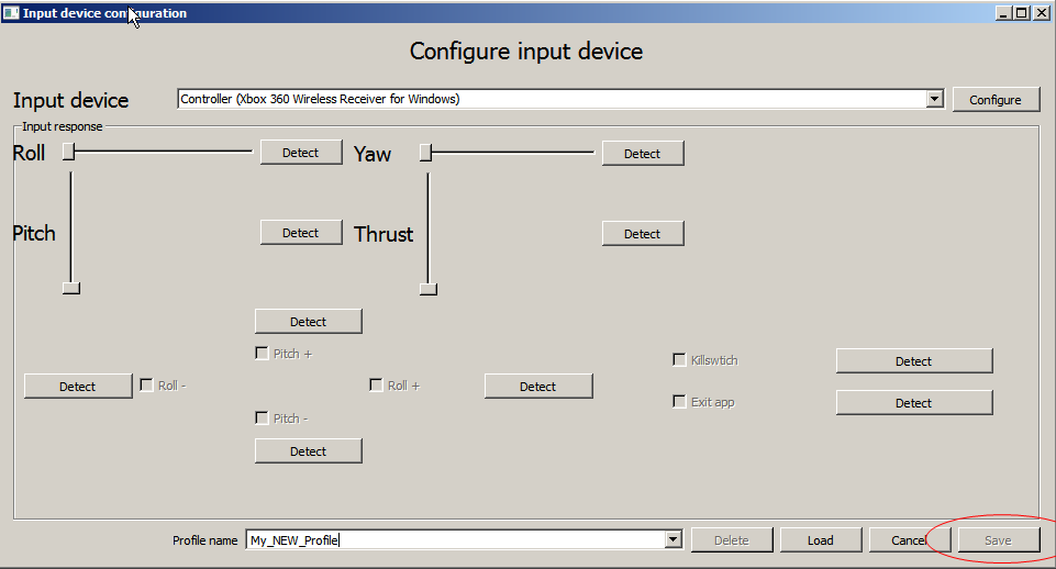

I'm trying to setup a new profile under the Configure Input Device option, but I can't save any new profile because the Save button is always greyed out. I'm using a Xbox 360 on Win 7. Is there something I'm doing wrong?

You have to select an axis or button for all of the inputs, including trim +/-, killswitch, and exit app before it will let you save the config currently.

Ah. Thanks jweather! That's not very obvious.
Also, with the Xbox controller, you run out of buttons to map to, since the digtal pad doesn't work right now. I guess this will be fixed at a later date.

skube wrote:Also, with the Xbox controller, you run out of buttons to map to, since the digtal pad doesn't work right now. I guess this will be fixed at a later date.
Yeah, we have a few issues for this. Hopefully all of them will be fixed in the next version.
Only digital buttons supported for trim
Should not require trim/estop/exit to save config
