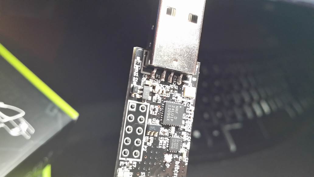

As the LEDs don't go on at all it is probably a powering issue.
Can you have a look for any missing components. I'm thinking the diode D1 might have come off. It is located directly underneath the USB connector. Also look at the soldering of the USB connector for any bad soldering.

That is correct D1 is off,  it does looks like all soldering are right.
please see images.
I will go over the soldering tonight, and see if this time works
						please see images.

So we found the issue. Why it is missing is another question...
What you can do is to solder a bridge over the D1 pads. It is safe as long as you don't power it from the expansion header as well. If you don't think you can do it contact seeedstudio to get it fixed/replaced.
