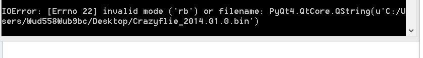

i just got this crazyflie , and i just try to upgrade this toy with new firmware but i couldnt do it
plz help me to upgrade my copter

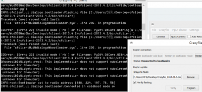

this happening when i click the programm button
i cant uprate my crazyflie

Re: i cant uprate my crazyflie
I've never seen this before. I will let Marcus know about it, he probably knows what the problem is. (access rights?)
yes when i click the program buttontobias wrote:I've never seen this before. I will let Marcus know about it, he probably knows what the problem is. (access rights?)
There seems to be an issue with the directory naming and support for the language. The workaround is to place it the file in a directory with only English letters. I've added an issue for this here.
Is the user home-directory in Korean?
