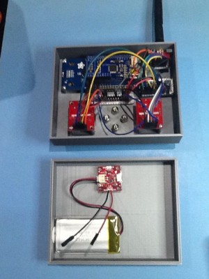

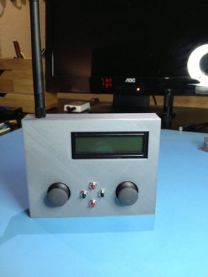

I'm not sure if anyone else is working on this. I wanted a simple handheld controller that I could modify to fit my needs. I developed some proof of concept code to verify that an Arduino connected to an nRF24L01+ could communicate and control a CrazyFlie. Here an link to my demo code if anyone is interested.
https://bitbucket.org/tbitson/crazyflie ... controller
The list of materials and STL file for the printed case is at https://tinkercad.com/things/lQYpViQbkG ... er-case-10 and will be poster to the repo soon.

Nicly done and it seems like it was a lot of fun to develop!
How well are the analog sticks working? Do they go back to zero when released and do they seem to have a good and stable resolution?

tobias - The small thumb joysticks are OK for indoor use. I disassembled the throttle joystick and removed the spring to allow full range. I'm looking to find a better joystick for controller.

humblehacker - for this first cut, a just used a Arduino Pro Mini 5V/16MHz. Once I get all the switches connected, I'll be out of pins so I will most likely move to a Mega, or possibly a DUE if I can get the RF24 library to work on the DUE. That would provide plenty of speed to and a color OLED display to graphically show heading like the CFClient.
