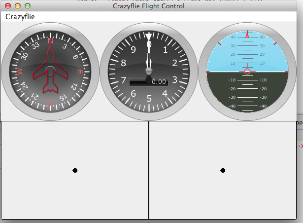

I will also preparing my GUI Project to bitbucket, it does already have Controller Support based on JInput lib.
I have attached a image how it currently looks like.
There are no special features available, the plan was first to get it flying
