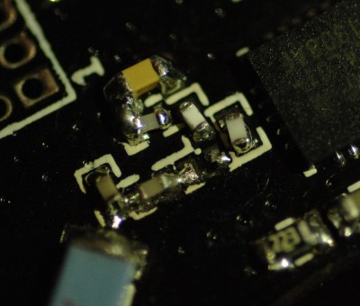

Device seem to work just fine except a very short range where it accepts a signal from crazy radio. I followed the FAQ instructions and did all the tests, replaced the antenna on the dongle. Same result. Well after playing a little I tend to think that the problem is on the board of the crazyflie itself. After checking the schematics I found out that I do not see L1 element. Please see a close-up picture of my board and tell me if I am right or wrong...
Schematics were taken from here: http://wiki.bitcraze.se/_media/projects ... _rev.f.pdf
page 3.
Thanks!
