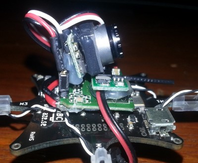

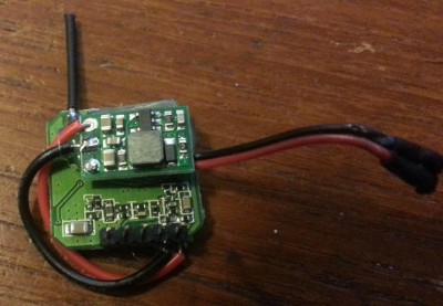

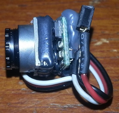

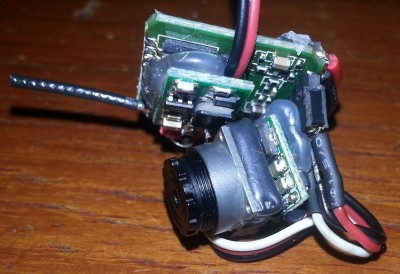

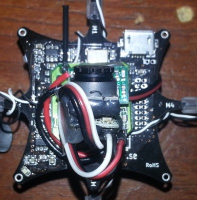

omwdunkley,
Used your thread to put together my first FPV system, nothing fancy, no camera mounts (aside from blue-tac) but seems to have come together quite well.
Defiantly onto a winner with the 5V Step-up.
I have horrible luck with photos and the internet so don't know if these will show up but I've attached what i put together based on your work and it all fits together really nicely. I'm using the connection from the headers on the transmitter to act as a mounting point for the camera, at the moment i just have a bit of blue-tac holding the combined camera+transmitter to the board while the cable goes up and over onto the jtag connections.
anyway, wanted to say thanks for putting up a good build page... i doubt i would have known about the voltage issues (Bit of a noob) and probably would have fried a few components before i put it together right.
oh yeah, it goes without saying... that be a bitchin HUD...
