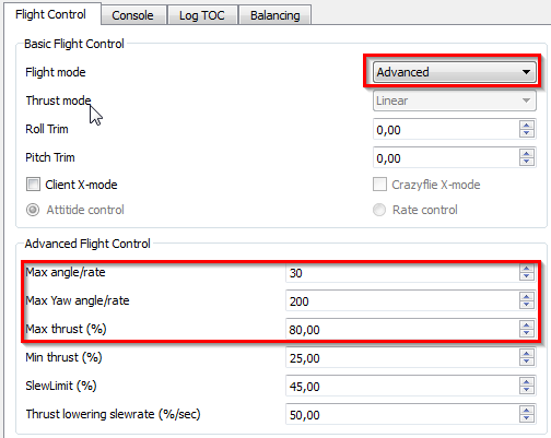

I have a question, is it possible to set the PS3 controller insensitive, so I can easily learn to fly the Crazyflie? (better control)
Because currently the crazyflie reacts with extremely big movements and makes it difficult to fly.
it is possible to adjust the joystick less sensitive?

It should be possible by just lowering the maximum angles in your PC Client:
First set flight mode to advanced, then lower the values for max angle and max yaw angle. You might also want to lower the maximum thrust.

To get better control over the thrust I set the minimum higher and and maximum lower, about 10% or 20% between them. It does varies abit as the battery gets flat, so you may need to adgust again. However in practice it does not last too long after the power first starts to dip.omatoasty wrote:Thanks, i will try it..
The direction buttons provide some trim if it consistantly drifts even after repeated correction. However you will always need to provide some manual correction, it can not be trimmed to hover perfectly. Reducing the other values make it a lot easier to control.
(It is common for GUIs to not accept values until the input looses 'focus'. I'm not sure if this GUI does the same, but I 'click off' the edited value out of habit, just in case. ie edit one value and then click on another. )
