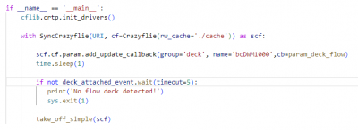

Hello Everyone,
I must admit that I am still quite a beginner. I was doing the Step_By_Step-Guide, given here: https://www.bitcraze.io/documentation/r ... commander/, and a problem has occurred. I don't understand why my deck, which I use, is not found. Can somebody help me out?
According to the client: I'm using the Deck: bcDWM1000.
What i did now is. I just changed the name of my Deck in the given script from the Step_By_Step-Guide:
And unfortunately my deck still can not be found. And i really need some advice, please.

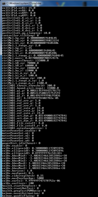

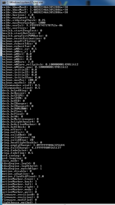

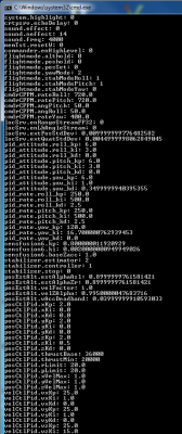

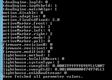

The output when i run the script is: "no deck is detected" as it is written in the function.

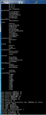

And the Output of the basicparam.py example is this:
As I can see, my deck (bcDWM1000) is also found in that.
Thanks,

Post by RubICS »
Yeah for sure! Thanks for you patience.
The output is "Deck is NOT attached!"
Thank you very much.

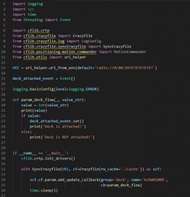

Hello Jonasdn,
i hope i did everything right. If so my code can be found here here: https://pastebin.com/SegtpYjL.

Thank you!
Am I right in understanding you do not get either of the:
print('Deck is attached!')
print('Deck is NOT attached!')
Outputs?
Could you try the following script? I modified it to ask for a parameter update.

Hello jonasdn,
i dont know what you did :D :D , but now my deck is going to be detected. Thank you soooooo much :D
The Output is:
1
Deck is attached!
:D :D
