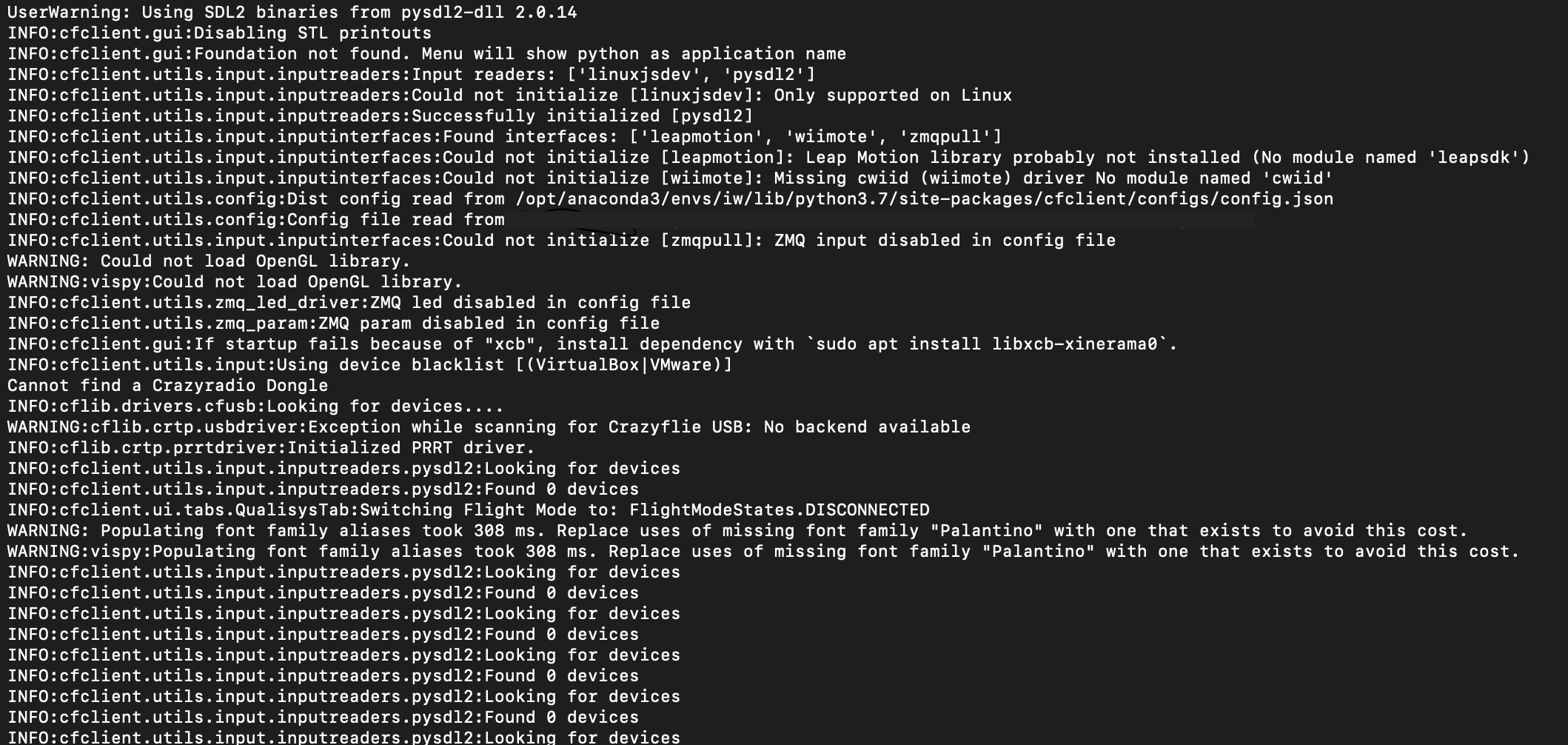

Here is the terminal output when I start the cfclient and search for Crazyflie devices:

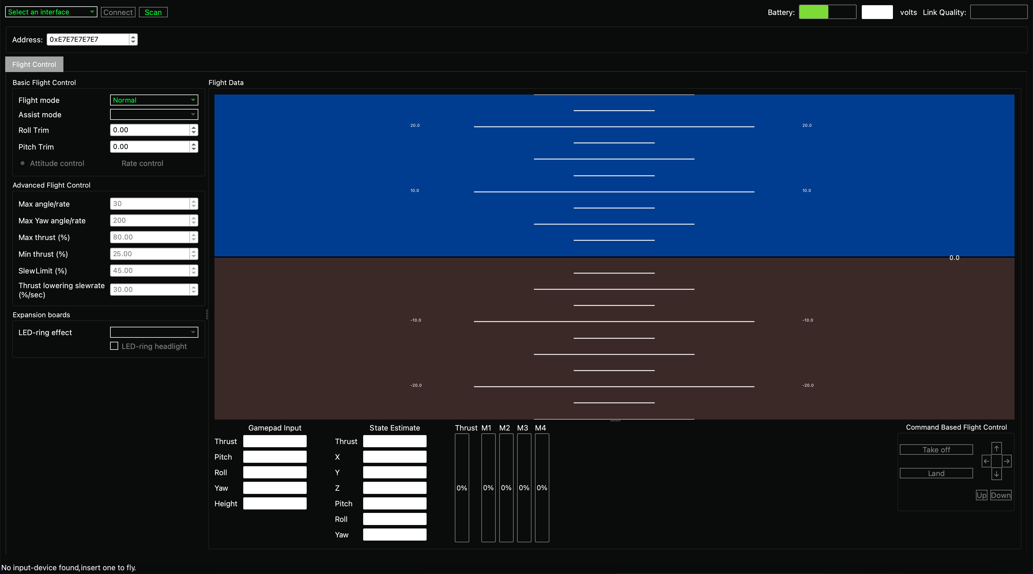

Here is what I see in the cfclient window:

This is consistent with the behavior when libusb is not installed.
Assuming you are using homebrew, you can install libusb with:
When the client starts it will automatically scan for Crazyflie which will light-up the RED led on the Crazyradio.
