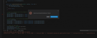

The debugging environment was working perfectly on my Ubuntu 16.04 laptop. However, in my Ubuntu 20.04 laptop, I got a "Failed to launch OpenOCD GDB Server. Timeout" error. A screen shot was attached.

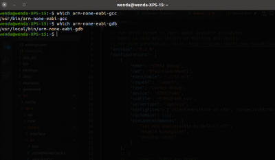

As a first step could you verify for me that you have the arm-none-eabi-gdb binary on your system?
It should probably be in /usr/bin/arm-none-eabi-gdb ...
Could you also paste the contents of your launch.json here? Thank you.

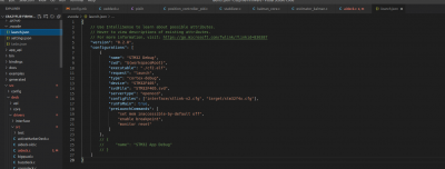

Hi jonasdn,
Thanks for the reply. The attachment is the screen shot of the arm-none-eabi-gdb and launch.json file.

How does your settings.json look like?
Perhaps you need to add:
"cortex-debug.gdbPath": "gdb-multiarch"
Or "/usr/local/bin/arm-none-eabi-gdb"
