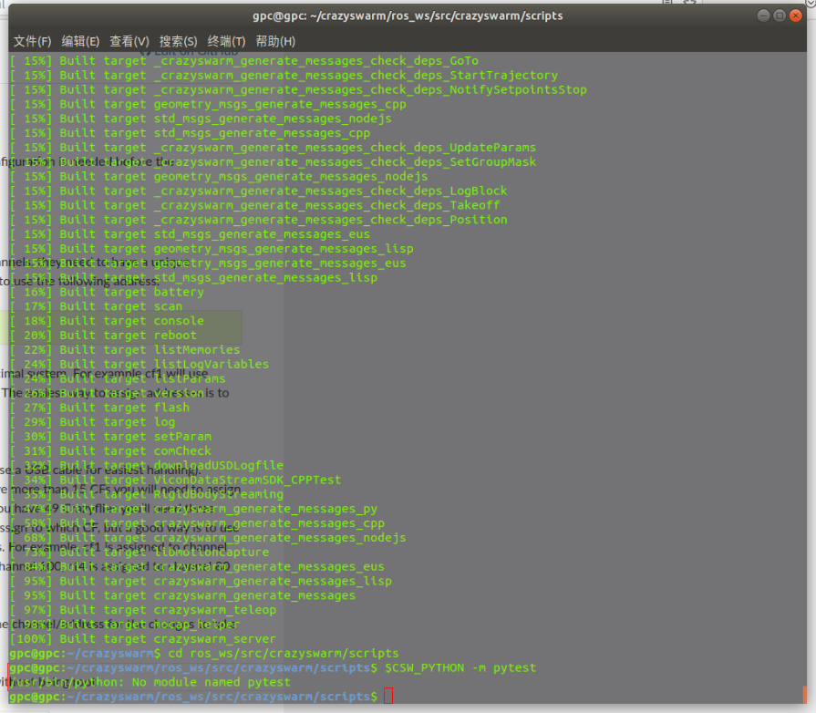

Hello everybody. When I install the environment of the crazyswarm follows the https://crazyswarm.readthedocs.io/en/la ... ation.html, but, when I run the $CSW_PYTHON -m pytest, it reported an error
. How can I solve it? I would be very grategul if you can help me.

Crazyswarm is not a Bitcraze project so it is not always sure you will get an answer here, a better bet would be to file a GitHub issue at https://github.com/USC-ACTLab/crazyswarm
But. This is a Python issue, you do not have the pytest python module installed, this can be fixed by running something like:
pip install pytest-
