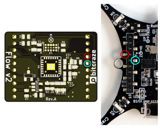

Do you have a multimeter so you could check that you have a connection between the CF2.1 and the flow deck? Especially check the i2c bus (pin 4,5 on the left side). To rule out soldering issue of the connector try to measure on the soldering pad. If you feel uncertain how to do this I can try to put together an explaining image.

Re: flow deck v2 error
Check that it is a connection between the two red measurement points and between the two blue when they are mounted together.
Also, do you have two flow decks or did I read that wrong?

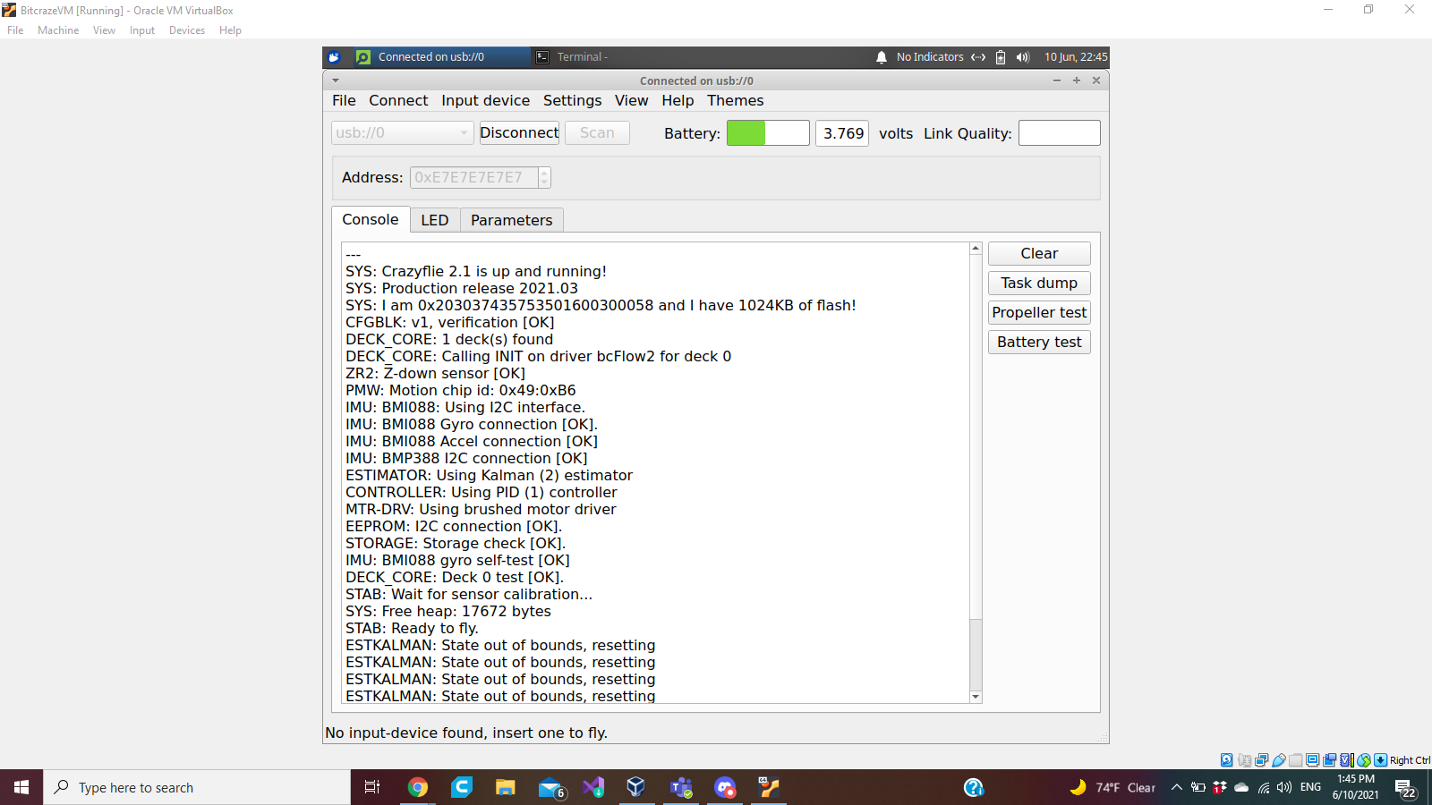

I changed the pins to see if the flow deck worked and it did for a while. Then it had the error again. You are probably right and there is a soldering problem.
OK, good, one step forward. Then we know it is a connection issue. I think then it is either the connector tongues or the soldering legs of the connector, and my guess is the latter. Can you try to inspect the soldering of the connector legs to the board. It is probably on the flow deck but could be on the crazyflie as well.

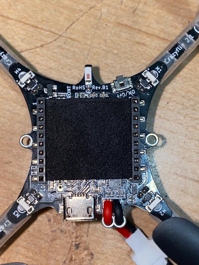

I think the soldering is good but I attatched an image in case you see something wrong.
It is hard to see in the image and it can be very subtle but often noticeable if one looks closely. Also the foam pad is in the way to see the inner legs. I highlighted the pads on the flow deck that are most likely to have a problem but it could be one of the others. If you feel uncertain perhaps you can take a close up high resolution image and possibly I could spot it.
After testing a bit myself I think it is most likely pin 1 (VCC) on the left side that is not connected.
