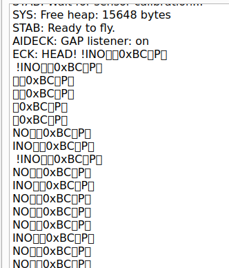

I'm trying to build a simple protocol on top of the UART between GAP8 and STM.
But even detecting a protocol header does not work properly. If it turns out that it is my own inability and lack of C knowledge, just ignore me :? - but I think what I observe may have something to do with the DEBUG_PRINT define.
All of the following is part of aideck.c and readUartMessage() is called from Gap8Task()
The attached screenshots show what I see in the console and what I see in the terminal where the cfclient is running.
I obviously receive the header both on the flie as well as in the cfclient, but why does all this other stuff show up? 0xBC - that sounds familiar. Is this part of the crazyradio protocol, and if yes, why does it appear?!

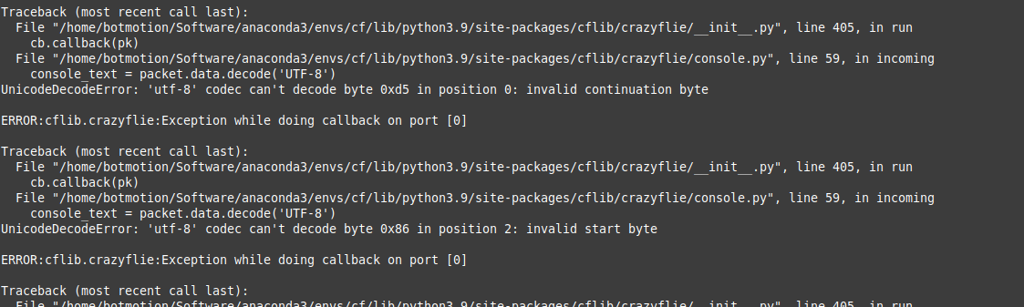

And why does the decoding of the message in the cfclient fail?
Any pointers to what I need to adjust would be welcome. Thank you!

I forgot to mention: the GAP sends
!INOxx
where xx = uint16 (two bytes). So the two squares in the console readout of cfclient after the letters are explained. It's generally why the decoding fails that I don't understand. Why does it show 0xBC<square>P<square>?
Re: UART Protocol GAP8 <-> STM | DEBUG_PRINT issue?
Could it be because the string is not NULL terminated? HEADER_LENGTH is 4 and should be 5 to account for the NULL termination.
