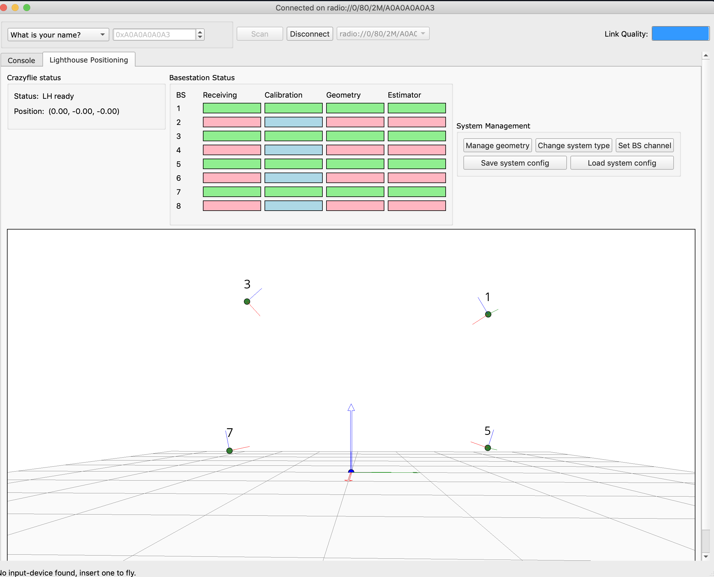

Hi Kristoffer,
I checked out the latest version of the lighthouse positioning tab today in response to Tobias's battery test function blog post.
It looks like the calibration and geometry data are no longer hard coded into the firmware?
How do you define the origin now?
I assume there is some documentation coming house soon for the new tab, so I am happy to just wait for that if it is coming soon. I just want to guage wether or not I move to this version of the cf-lib and draw inspiration from the lighhouse positioning tab for our solution? Rather than our current solution which is building a script that will generate an origin and rotation matrix that will later be hard coded.

Hi Joe,
yes, we are implementing a proper user interface for managing lighthouse systems. Geometry and calibration data will be stored in the persistent memory in the CF instead of being hard coded in the firmware. This means the lighthouse system can be used with the stock firmware and there will no longer be necessary to build a special lighthouse firmware. The UI will be limited to 2 base stations for now but we will add support for 2+ base stations later. We want to get a first official version out and I think 2 base stations is the most common use case so we settled for that. Geometry estimation for 2+ base stations is more complex (as you know
) and we will have to contemplate a bit on how to do that.
Even though the UI is designed for 2 base stations, most of the functionality (in CF and client) should actually work for 2+ base stations as well. In your case I think using the persistent storage for geo and calib data would be a convenient solution. You could probably use the stock firmware which would simplify things.
The geometry data is read from the persistent storage at start up (if available). The main use case for calibration data is to read it from the light sweeps and store it to persistent memory to make it available immediately after boot. If you want to read calib data from the USB on the base stations, that is also fine. Note that we added a UID to the calibration data.
If you have more than 2 base stations, I have a slight worry that there will be interference between base stations when receiving calibration data through the light sweeps. If this is a problem turn on one base station at a time and let the CF get the calib data (you will get a notification in the console log and the lighthouse.bsCalCon log variable) which automatically will be stored in persistent memory.
There is now a system config file format that contains geometry and calibration data, that enables a user to save and load full system configurations. The easiest way for you to understand the file format is probably to save a file from the lighthouse tab and look at the file. It is pretty straight forward.
I'm not sure how you designed you tool, but this file format may be a way for you to transfer information?
There is a script in the crazyflie-firmware repo (tools/lighthouse/upload_config.py) that reads a system config file and writes it to the CF that might be useful to you.
Documentation is on its way, but we want to finish the implementation first.
Let me know it you want to set up a meeting for a more detailed explanation

After all these heavy modifications to get_bs_geometry.py using Kristoffer Script from early in this thread we pulled something together that got the BS in kind of the right place, but were having serious problem with the averaging of the quaternions.
Then we realised (after installing all the lighthouses) that if you just raise the lighthouses a little more but still have them angled up. you can just use the manage geometry window to calibrate in one styingle step...
But I guess all this had to happen for anyone to realise this. Tims and Kristoffers work on this is still really valuable to anyone who wants to stitch together multiple coordinate system (especially across multiple rooms), there mus't be that far to go.
they sit about 400mm off the ground and are angled up about 10 degrees.
Wow what a ridiculous Journey... Thank you all for your help.
Now on to the next promlem... when we turn on over 4 Lighthouses the CF does not recieve any of them
