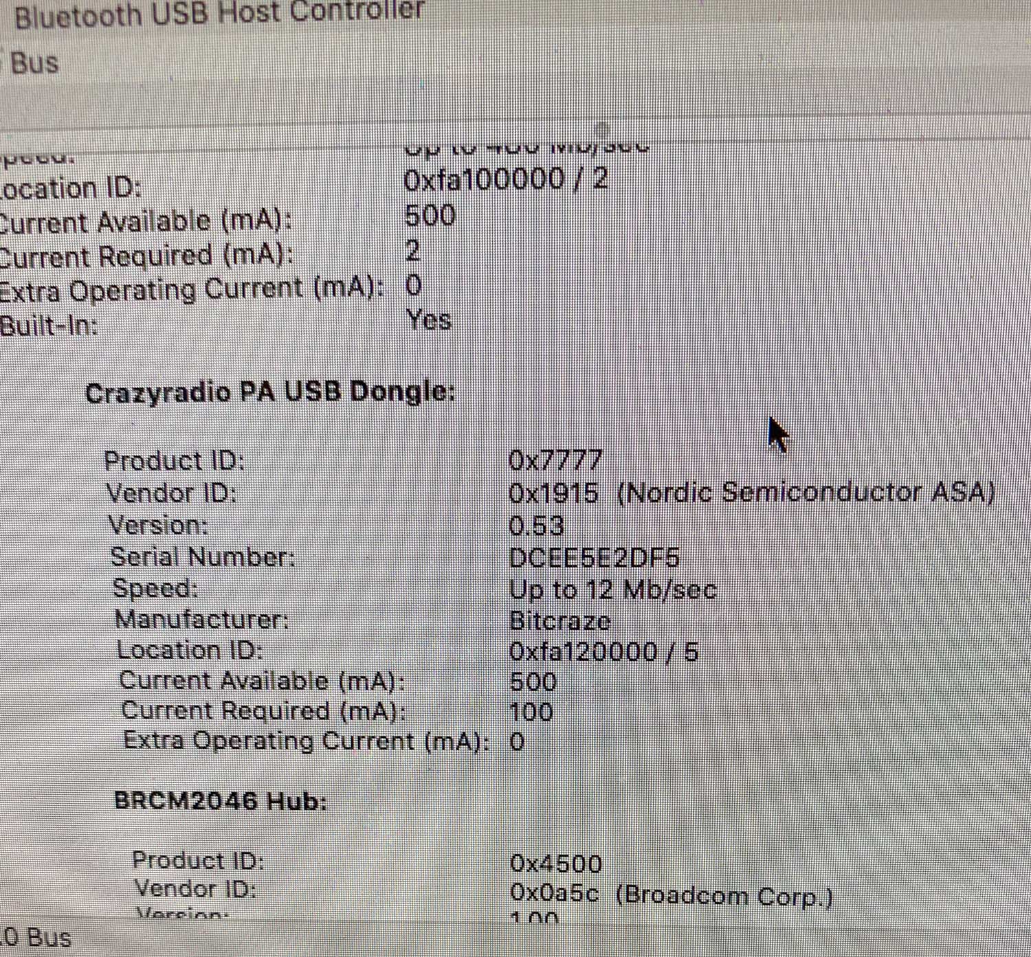

When I did this the CrazyradioPA was not recognised on the PC, although I installed the driver from Zadig - I tried all 4 versions - CrazyradioPA is recognised by the PC (see photo.)

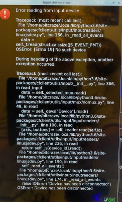

I tried my Mac again, things booted-up fine - for 10 seconds - then I got this message (Error message on Mac - photo)

Your first screenshot seems to be taken on a mac, not on Windows. The second one hints of a problem with the gamepad and not with the radio, it comes from the gamepad being disconnected.

There’s no problem with the game pad.
The issue is with the CrazyradioPA !
It will not connect to the Mac - it will not connect to the PC either.
Let’s start with the Mac, as it was working fine until I tried the CrazyradioPA in the PC.
Then I got the message in the picture on the Mac.

The error message you took a screenshot of is emitted by linuxjsreader.py which is the gamepad driver used in the client, it does comes from the gamepad. Though, the error is about the device being disconnected so since both the gamepad and the radio are connected over USB, there might be a link.
One way to debug the situation is to find-out if the radio is seen on the Linux side in the VM. After you pass the radio to the VM, it should appear both in "dmesg" and in "lsusb", by typing both commands in the console just after passing the radio to the VM you should get something like that:
If that happens, the next things to look at is the log when launching the client. You can launch the client from the console with the command "python3 -m cfclient.gui", it the radio is well recognize, towards the end there should be the line "INFO:cflib.crtp.radiodriver:v0.53 dongle with serial N/A found
", otherwise there should be an error indicating that the radio could not be opened.
If the radio gets disconnected, both lsusb and dmesg are good commands to get more information about what happened.
