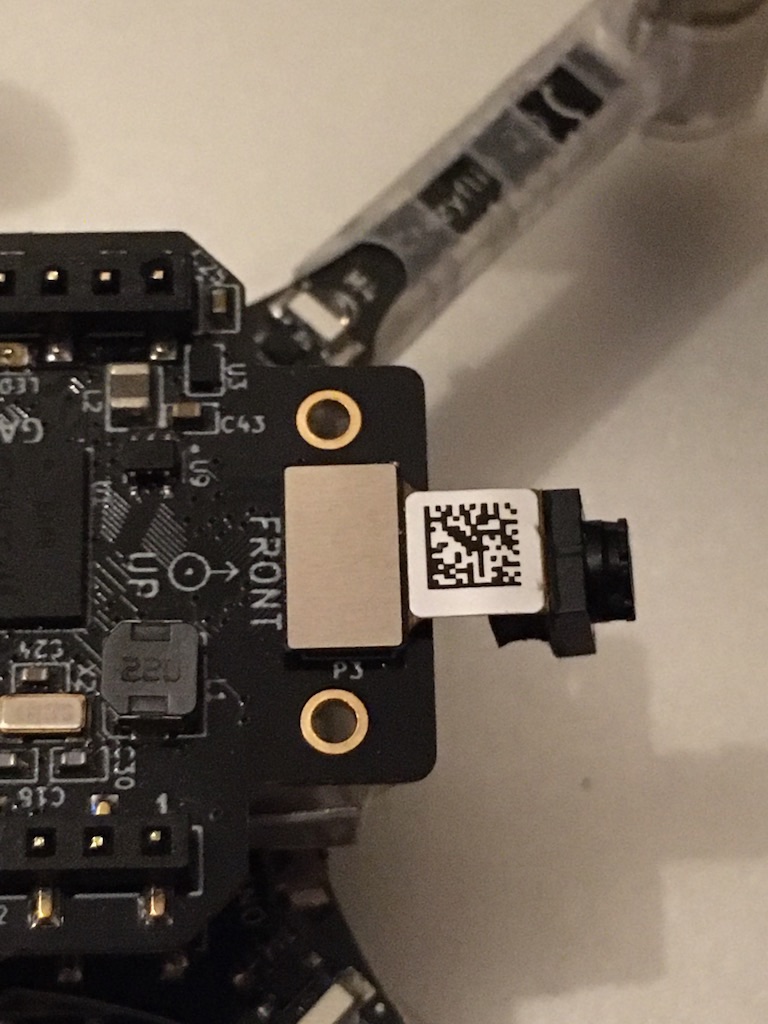

here is the camera mounted without the cover. Is the notched wheel around the lens used for any purpose? I unplugged and re-plugged the camera a couple of times to make sure is in porperly. Can i test the camera with the cover off?

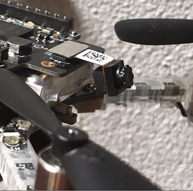

hi
this photo may be clearer

Thanks for the picture!
The connection seems good, but I'm worried about the condition of the flex PCB. It looks sharply bent and snapped, and I'm afraid that the flexpcb now is broken and the connection between the camera and the gap8 are disconnected...
Do you have another grayscale camera which you can try out?

I don’t know how that could have happened, because I was extremely careful when I installed it. No I don’t have another grayscale camera I got this one free of charge from bitcraze as they offered it to people who have the version 1.0 of the ai deck. Well I don’t know what to do, could it have been already damaged when I received it?
I feel terrible asking for a replacement as this one was free of charge.
Regards
Rodrigo

Hi Rodrigo,
Send us an email at contact_at_bitcraze.io and we can help you out with this :) We haven't really provided a clear instructions how to install it either so we think it's fair to give you another code.
