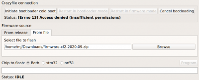

Also, the second attachment shows that the firmware cannot be bootloaded to my system. Is there any way I can solve this problem?

The error you get indicates that you did not install the correct udev rules file that would give access to the Crazyradio to normal users (ie. not only to root).
If you follow the instruction there, it should solve the problem: https://github.com/bitcraze/crazyflie-l ... ermissions.

Just solved the problem. Thank you!
