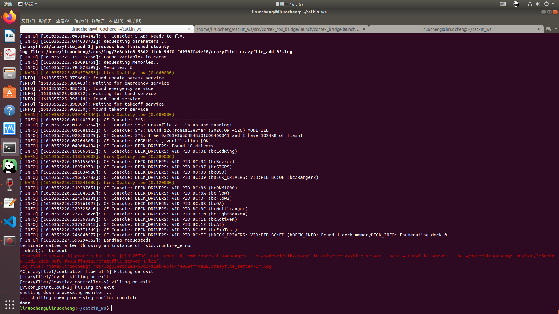

Hi,recently I'm trying crazyflie_ros.
I use the command
roslaunch crazyflie_demo hover_single.launch
and an error occurs:|
[crazyflie_server-1] process has died [pid 20730, exit code -6, cmd /home/liruocheng/catkin_ws/devel/lib/crazyflie_driver/crazyflie_server __name:=crazyflie_server __log:=/home/liruocheng/.ros/log/3e8cb1e8-53d2-11eb-96f0-f4939ff49e28/crazyflie_server-1.log].
log file: /home/liruocheng/.ros/log/3e8cb1e8-53d2-11eb-96f0-f4939ff49e28/crazyflie_server-1*.log
I restart the cf and the error still occurs...however, the problem was solved when I connected the cfclient once. But it will happen again when I restart the cf, so I have to connect the cfclient first before running the cf on ros...
I wonder why this kind of problems occurs. Right now I guess it may be the problem of the firmware. I have changed the firmware's makeflie and force the estimator as "kalman"

Error: Do you have any other outstanding changes or the DEBUG mode enabled in your config.mk file of your firmware? Some of the printouts shown in the screenshot (enumeration of all deck drivers) seem non-standard to me.

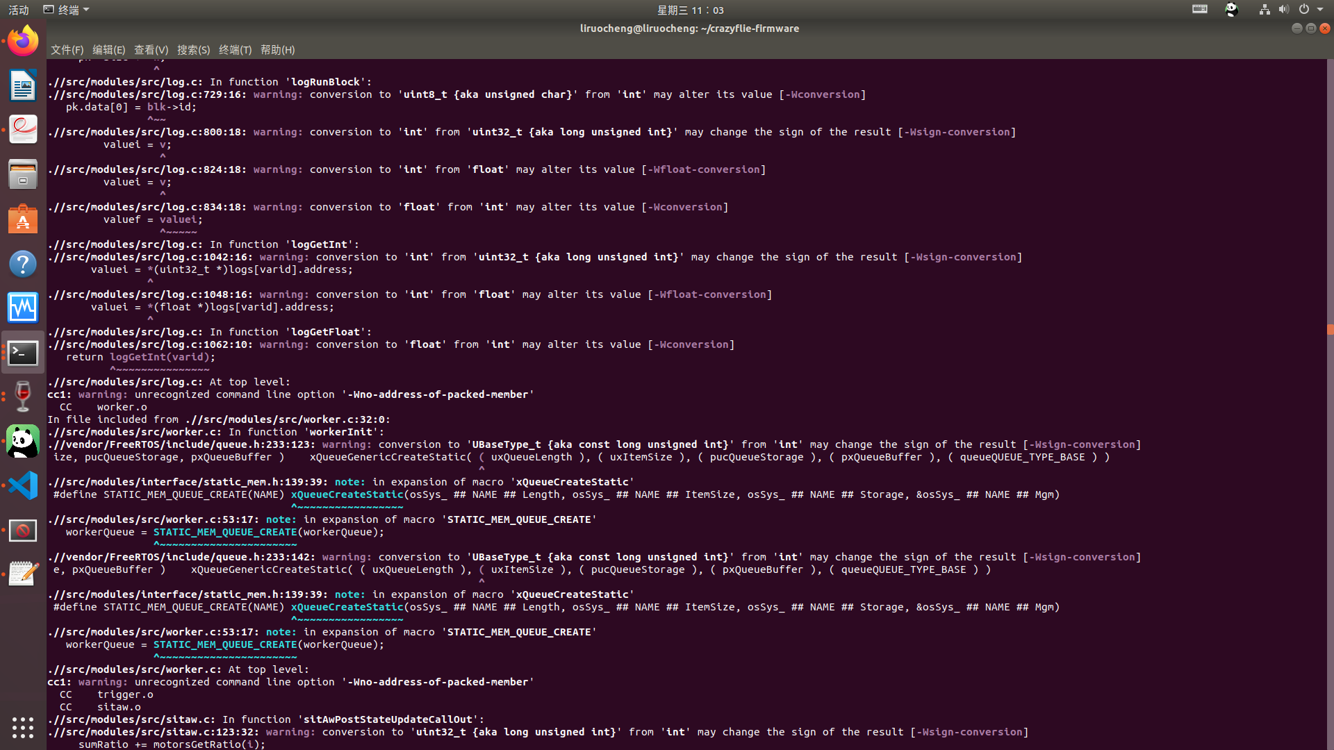

DEBUG=1
I have added this two lines in this flie and when I execute "make" there are many "warnings" in the cmd window...
Then I change the DEBUG=0 and remake the firmware and there are no warnings any more and the error disappear
Now I'm wondering why...
Here are part of the warnings when the DEBUG=1

There is one extra warning flag enabled in the compiler by the Makefile when compiling in debug mode, this is why you are seeing more warnings in debug mode.
