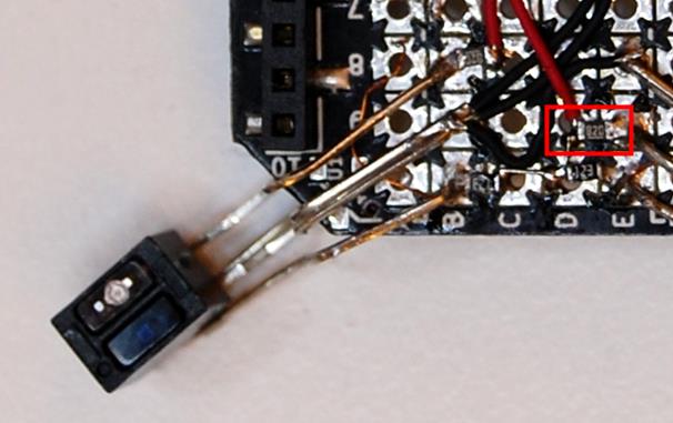

1.Is this resistor "Thick Film Resistor" used"?
If that used, Can I change the "Carbon Film Resistor" generally?
2. In Prototype deck, If I solder in 1(row)-A(column), Is hole 1-A connect with pin 1 automatically?

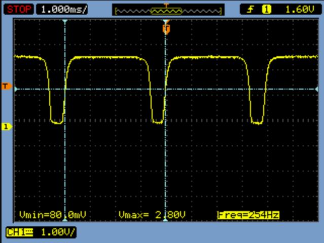

3. What do you use scope program in the post?

1. Yes you can use Carbon Film resistor instead
2. Yes
3. To verify the output from the sensor. That it detects the spinning propeller and that the signal looks good.
