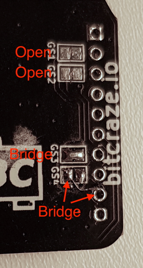

We are not working on anything like that here. You need to be aware though that the lighthouse deck and LPS deck are not yet compatible (see here). You will need to adjust the LPS deck like in the picture:
