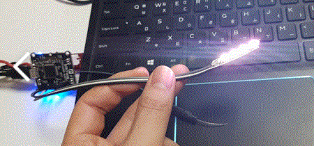

I looked through the files you taught me.
But the file was a simple led on-off file.
The module I want to do is as shown in the following picture and is the same module as the leadring deck on your homepage.
The code we looked at to implement this is ledring12.c (crazyflie-firmware/src/deck/drivers/src/ledring12.c)
I want to control the files on the led tab on the client with the stored code.
The pins will use pb_5 (the same pins as the ledring-back pins)
The low pin cannot be used because only the matrix exists.(Why direct control without using the client's tabs)
SH_Lee
Posts: 51
Joined: Tue Feb 18, 2020 8:48 am
Re: use ledring12.c file
Post by SH_Lee »
After I posted this article, I found a very simple way to do many experiments.
The function in the ws2812.c file was used without the code from the ledring deck.
And in the schema of the ledring deck, the power part is connected to the vcom, and I connected it to the vcc.
I don't know why, but the voltage/current doesn't seem to match the module I use.
I attached the code I used below.
When I tested various colors and brightness, I was very satisfied.

One suspicious part is 'DMA1_Stream7_IRQn'.
I didn't know exactly what function this was set.
I conducted an additional experiment over the weekend.
Immediately after starting the cracyfly, we determined that the waveform and subsequent waveforms were different.
Before "Ready to fly" was output from the console of the client, the waveform was output normally and then the output changed.
1. before print "Ready to fly", same as normal code
2. after print "Ready to fly"
Regardless of the existing code, the same waveform is output, but the changed code has identified the different house.
Therefore, I don't think it's a problem with rtos, and I doubt the possibility of changing the timer or dma setting in the middle.
In other words, I think this situation can occur by setting different settings for the timer or dma_stream that I want to write to in the middle of a different file.
1. I wrote the wrong code.
2. The code has no problem, but changes the setting for the corresponding timer (TIM4_CH3) or DAM_STREAM7 in another function or task.
Do you have any other ideas related to this?
I think this is a resource collision problem because the TIM4 is used by the motor driver. Could you maybe use TIM3_CH1 on PB4 (IO_3) instead?
SH_Lee
Posts: 51
Post by SH_Lee »
I solved it after reading your article :D
I solved the problem, but I still have questions.
Each timer and channel is assigned to each dma stream and dma channel, which I understand is all independent.
Even if the timers are the same, if the channels are different, I think they are assigned to different dma streams and dma channels.
Therefore, I think there is no resource conflict.
If what I know is wrong, please correct it.
I would appreciate it very much if you could share your knowledge.
I'm note 100% sure of this either but the timer setting is common for all channels so if you still have the same settings each channel is independent. However I think the motors and ws2812 requires different timer settings.
