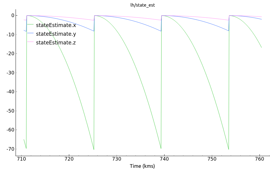

Now, when I check the cfclient, the raw and compensated angles plot change as I move the drone around. But the problem is that the x,y,z state estimate plot is messed up. It does change when I move the drone around but the values are not reasonable. And in the console, I get the "ESTKALMAN: State out of bounds", resetting message.
Where could I be going wrong?
