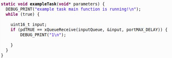

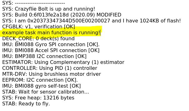

I saw the test example and added a new test.
After uploading the code, there was no response in the result window.
I simply wanted to make sure that the rtos worked internally.
We raised the rots priority from 1 to 4 in the example, but the results were the same.
Did anyone succeed in this example?
task not working

After adding a new task, the console results show the following:
I think it's because of the delay inside new task.
I used but the internal delay time was reduced and the console output cycle became longer.
