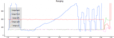

I'm running into an odd issue when I use the multiranger deck. Instead of mapping clear distances a near random map is made with huge variance in the distance perceived with no movement of the environment. In the below example the drone rotated 720 degrees, and flew up 2 feet and then back down. The LED's, and logs all suggest that the drone is working correctly, and I've tried two different multiranger decks and crazyflie 2.1 drone bases. Currently, I also have flow v2 attached as well, but the errors happen regardless of the attached flow deck.
I've also tried changing the size of the walls from roughly 10'x10' to down to roughly 3'x3', in both cases the variance was large enough to make the data look random.
Does anyone know if there is something that needs to be set for the multiranger to work correctly? Or if I need to use a different firmware? So far I've tried 2020.06, 2020.09, 2020.04, and the default firmware installed on the drone (I'm not sure which one that would be).
