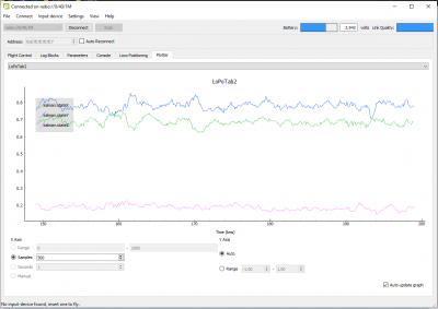

Ah, I see! I've taken a look at the State.Z log (which is under the LoPoTab2, I assume) and took a screenshot of it. I've attached the photo here. My LPS nodes are currently a little above the ground (around 20cm) if that means anything.
And yes, the government just announced a work from home for all except essential sectors so I have moved all my setup home a few days ago. Feel free to share about this!
Edit: I've tried the same code on my other 4 Crazyflies and they are giving me inconsistent results in terms of flying. 3 of those won't lift off the ground while 1 of it will just "run" towards the (+x,-y) direction. I'm really confused to as what's causing these problems.

So currently the crazyflie thinks it is already 20 cms of the ground. Currently, the motion commander gives a default command to take off at 30 cm, which is only 10 cm higher. So what will happen, is that the crazyflie will only try to go up about 10 cms. Since the LPS system also have cm accuracy, this estimate can differ about 5-10 cm in the z direction. The other crazyflie probably already think that the have already reached 30 cm and therefore will not take the effort to take off. So there are two ways to fix this:
Great for letting us share it! Can you let us know from which lab/twitter you are, and if there are any hastags/names/ or links that you want us to use to give it more context?
- Give it an higher z setpoint, either with commander setpoint or with MotionCommander(scf, default_height=0.8) as mc: 0.8 is to replace the default of 0.3)
- Reset the LPS positions: https://www.bitcraze.io/documentation/t ... -positions. In your case, you will need to add the extra 20 cms in the z axis

That seems to have fixed the problem with the motion controller. Thanks!
