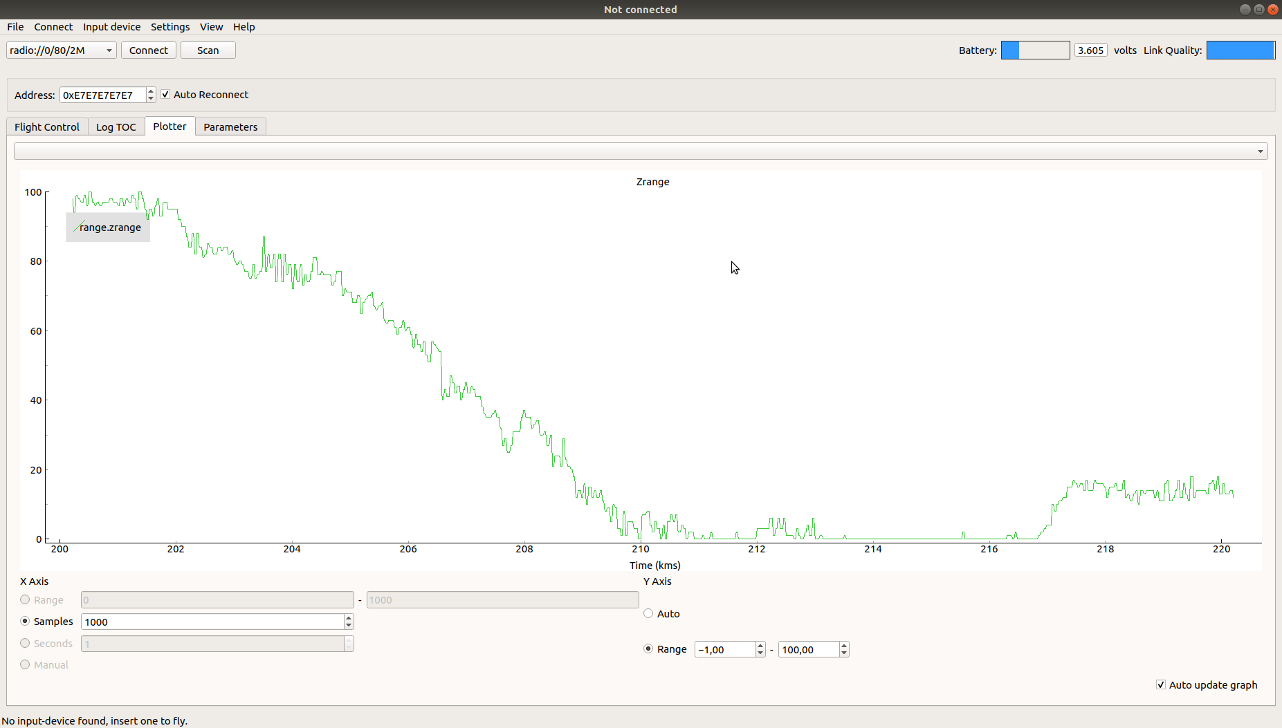

Example of "weird" sensor readings from one of the flowdecks:
The following graph was extracted from the client when lowering the cf slowly by hand from 10cm to 0cm. As you can see, the readings are good until a few cm off the ground where they seem to clip to zero. Then, when the drone is 0cm off the ground (i.e. stationary on ground), the readings are ~1.5 cm.

This compensated for the offset, but for the nonlinear "clipping" phenomenon.

Hi, I just moved the topic.
We don't (re)calibrate the sensor when the flowdeck/zranger decks are assembled. We assemble the sensors as is and only test the connection with the sensor.
So the datasheet of the VL53L1x does say that any measurement under 4 cm is unreliable: https://www.st.com/resource/en/datasheet/vl53l1x.pdf (page 16. 3.3 Minimum ranging distance). So that you are seeing this at 1.5 cm might be due to that.
We are not exactly sure why it is unreliable though below the 4 cm limit.

In our ctrl+f of the documentation we apparently missed the minimum ranging distance... :roll: Thanks for pointing that out!
