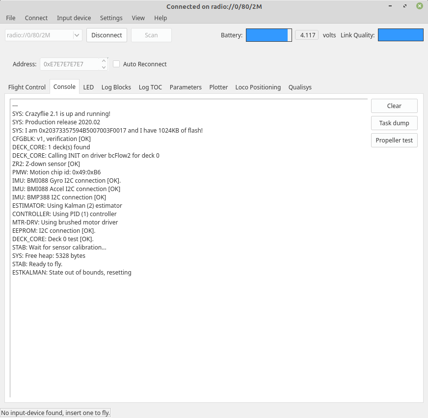

here are the requested screenshots of my cfclient. The only tab showing a problem is the "Log Blocks" tab, afaik.
Let me know if you need more info about my system / installation. Thanks for your assistance.
Regards
Tintin

Here's some updated info on the issue: after upgrading from Linux Mint 19.3 to LM 20 the logging tab is now displayed correctly:
