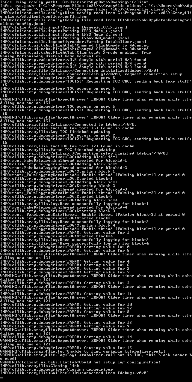

I'm attaching a screenshot of the debug console.

When you press the connect button do you get an alternative similar to "radio://0/10/250K"?
In the log I can see that you have connected to the debug://0/0 driver which is only there to test the UI and doesn't connect to the Crazyflie.

Awesome, thank you Tobias. I feel pretty stupid, but it works now!
