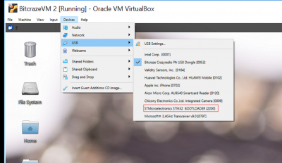

Ah... USB problems with VM's are really difficult to solve. So you are not seeing the 'STMicroelectronisc STM32 BOOTLOADER' like in this image?
Are you running the VM in Ubuntu, IOS or Windows?

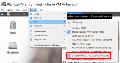

Just a small update, you have to make sure 'STMicroelectronisc STM32 BOOTLOADER' is selected: like this:
After selecting I got the following in my console:
bitcraze@ubuntu:~/projects/lps-node-firmware$ make dfu
dfu-util -d 0483:df11 -a 0 -D bin/lps-node-firmware.dfu -s :leave
dfu-util 0.9
Copyright 2005-2009 Weston Schmidt, Harald Welte and OpenMoko Inc.
Copyright 2010-2016 Tormod Volden and Stefan Schmidt
This program is Free Software and has ABSOLUTELY NO WARRANTY
Please report bugs to http://sourceforge.net/p/dfu-util/tickets/
Opening DFU capable USB device...
ID 0483:df11
Run-time device DFU version 011a
Claiming USB DFU Interface...
Setting Alternate Setting #0 ...
Determining device status: state = dfuERROR, status = 10
dfuERROR, clearing status
Determining device status: state = dfuIDLE, status = 0
dfuIDLE, continuing
DFU mode device DFU version 011a
Device returned transfer size 2048
DfuSe interface name: "Internal Flash  "
file contains 1 DFU images
parsing DFU image 1
image for alternate setting 0, (1 elements, total size = 89208)
parsing element 1, address = 0x08000000, size = 89200
Download	[=========================] 100%        89200 bytes
Download done.
done parsing DfuSe file
Transitioning to dfuMANIFEST state

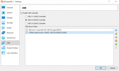

- Check if the following setting is enabled in the Oracle Virtual box before you open de VM
- If it all does not work, restart your host computer and VM.
Eventually the USB devices will connect after trying these things, but I couldn't find a magic formula that worked immediately. These USB problems with virtual box is different on every other host computer... (I have windows 10 btw)
