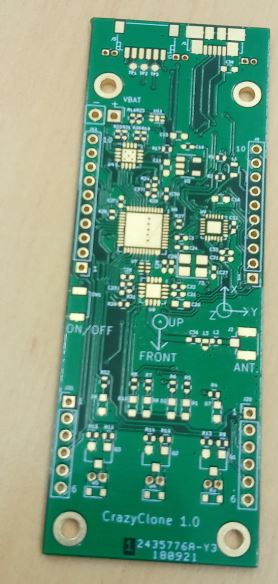

Hi. I am currently working on a custom made board where the my professor wanted to make a hexarotor from the crazyflie quadrotor. The board is a clone of crazyflie 1.0 with the only padded output being the pin-out for the two extra motors. I have flashed the board with the crazyflie firmware (cf2 bin) but the board does not come-up. Can someone guide me on how to flash a new (never flashed) crazyflie.

Thanks for the reply. sorry for the mistake in the previous post, actually the board is clone of the Crazyflie 2.0. I have attached the schematic in pdf of the board I adapted. I now need to load to crazyflie firmware from scratch. the pin_out have not changed and only added pins for two extra motors and LED to suit a hexarotor design.

Thanks #tobias. I will update the progress. for now am still in the incubation stage. I have two questions though. I am using the st-link debugger (white one) . It does complete memory erase when flashing new firmware. How do i manage all the three firmwares without erasing the previous. On the case of the nrf51, crazyflie disconnected the pinout for the chip in their design. Do i need to reconnect the pinouts to flash the nrf firmware or i can still flash it through the SWD via the stm32.

Hello tobia, I am using ST-link SWD for the stm 32, is it possible to use it with the nrf. I am always getting an error 'writing address 0X00000000 is not supported with JTAG/SWD debug port'

Hello. Can someone please help me out. I want to flash the nrf51822 for the crazyclone. I can successfully read and flash the hex into the chip. I am however confused on which hex and which sequence is should follow regarding softdevices, application and bootloader. I have the following hex generated from the program in the eclipse:
1. cload-nrf-V10. hex and nrf-mbs-V10.hex under bootloader
2. cf2-nrf.hex or bin
3. tag-nrf.hex
I also have the s110-nrf51822-7.3-softdevice.hex
