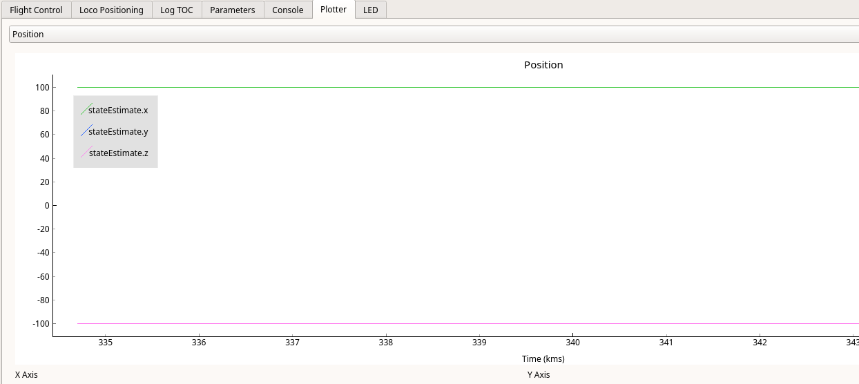

Im currently stuck trying to get my lighthouse setup to work...
Whenever i connect to the CF it shows each axis as either 100 or -100 (the max bounds) Everything is working fine with my VIVE, and i got the coords from the python script:
{.origin = {-3.539751, 2.505963, -1.972867, }, .mat = {{-0.837010, 0.280634, -0.469744, }, {-0.090894, 0.775235, 0.625099, }, {0.539586, 0.565911, -0.623371, }, }},
{.origin = {2.169446, 2.587589, 1.957343, }, .mat = {{0.742896, -0.279863, 0.608098, }, {-0.087531, 0.860001, 0.502730, }, {-0.663660, -0.426704, 0.614394, }, }},Code: Select all

STAB: Ready to fly.Can anyone help me get an accurate location?
