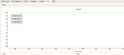

Whenever i connect to the CF it shows each axis as either 100 or -100 (the max bounds)

Flashing the CF with new firmware including the lighthouse geometry was no problem, and when i reboot the CF the red and blue LED's from the lighthouse deck both light up shortly.
Can anyone help me get an accurate location?

How does the LED sequence on the lighthouse deck look like? During normal boot red and blue led should go on and after that red should turn off so that only blue is lit.
Do you get any reasonable values from the lighthouse.angleXX logging variables?
