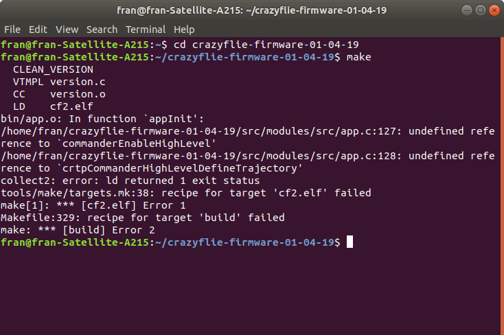

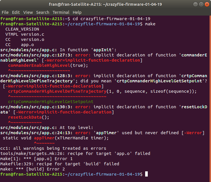

OS is Ubuntu 18.04, we have a local version of the firmware but is the last version with a few changes in the size of the trajectories memory in the high level commander module.
this is a transcription of the message in terminal:
CLEAN_VERSION
VTMPL version.c
CC version.o
CC app.o
src/modules/src/app.c: In function 'appInit':
src/modules/src/app.c:127:3: error: implicit declaration of function 'commanderEnableHighLevel' [-Werror=implicit-function-declaration]
commanderEnableHighLevel(true);
src/modules/src/app.c:128:3: error: implicit declaration of function 'crtpCommanderHighLevelDefineTrajectory'; did you mean 'crtpCommanderHighLevelGetSetpoint'? [-Werror=implicit-function-declaration]
crtpCommanderHighLevelDefineTrajectory(1, 0, sequence, sizeof(sequence));
src/modules/src/app.c:130:3: error: implicit declaration of function 'resetLockData' [-Werror=implicit-function-declaration]
resetLockData();
src/modules/src/app.c: At top level:
src/modules/src/app.c:24:13: error: 'appTimer' used but never defined [-Werror]
static void appTimer(xTimerHandle timer);
cc1: all warnings being treated as errors
tools/make/targets.mk:26: recipe for target 'app.o' failed
make[1]: *** [app.o] Error 1
Makefile:329: recipe for target 'build' failed
make: *** [build] Error 2
