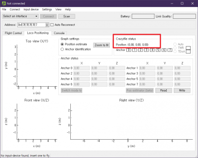

Recently, i bought 10 crazyflie 2.0 and LPS deck.
I'm using now the most recent firmware, VM provided from Bitcraze and 1 Crazyradio dongle. The problem is that i can use PC client utility for 1 cf2, but not for cf2 more than 2EA.
The only thing that i want is to read position value(marked as pictured below) of crazyflie more than 2.
There's no need to set up to make 10 Crazyflies flying, I just wanna get position value simultaneously.
Any suggestion and recommendation would be a great help.
Thanks in advance!
Use PC Client for 10 Crazyflies
Re: Use PC Client for 10 Crazyflies
In order to get the position simultaneously of 10 Crazyflie you will need to either make your own Python script or to use another client like ROS.
Unfortunately I do not think we have ready-made example script for logging 10 Crazyflie at the same time. You should be able to assemble the multiramp example that connects multiple Crazyflies (https://github.com/bitcraze/crazyflie-l ... ltiramp.py) with the basic log example that logs values from the Crazyflie (https://github.com/bitcraze/crazyflie-l ... asiclog.py) to log all 10 Crazyflies at the same time. The position shown in the LPS tab are in the log variables "stateEstimate.x", "stateEstimate.y" and "stateEstimate.z".

I decide not to use PC client(through making my own Python script). I just add source codes in Crazyflie-firmware so Crazyflie sends their position value to another PC program. So I wanna know is how to recognize Crazyflie state whether it's connected with Loco positioning nodes.
I'm going to use 6 nodes, 10 Crazyflie, and radio dongle!
And could you let me know a sort of steps(process i mean) to set-up my radio dongle, Crazyflie etc.?

There is unfortunately no simple way to detect if the Crazyflie has found its position or not. There is a "hack" that we often use though (not fool proof) that might be interesting. You will find a python implementation in https://github.com/bitcraze/crazyflie-l ... py#L59-L97 and one in C in https://github.com/bitcraze/crazyflie-f ... #L237-L279
The best way to get started with the Crazyflie and Crazyradio is to check out our tutorials on https://www.bitcraze.io/
In general, use one frequency (channel) per Crazyradio and different addresses for each Crazyflie. In your case if you have one Crazyradio you could for instance configure the Crazyflies to use
radio://0/70/2M/E7E7E7E701
radio://0/70/2M/E7E7E7E702
radio://0/70/2M/E7E7E7E703
