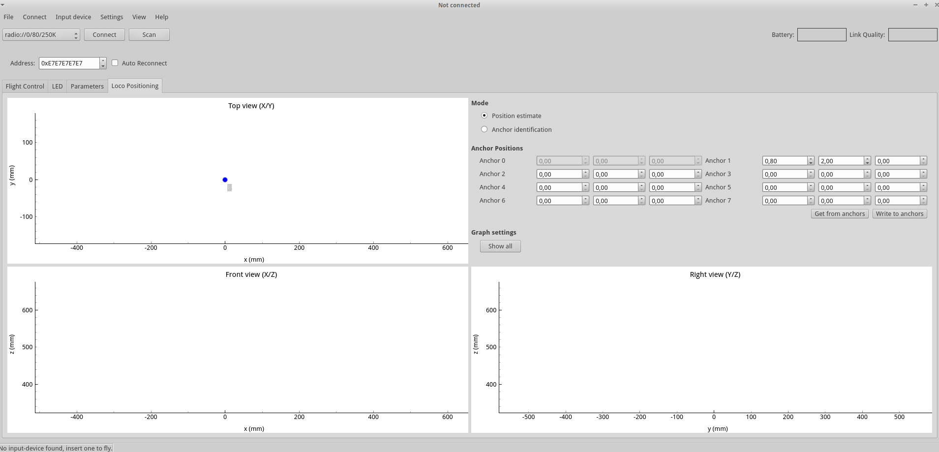

I recently obtainted a couple of CF's with lps decks, a PA antenna and 4 lps nodes. I had a great time flying the drones around with a controller, but now i am looking into flying autonomously with the locopositioning system. However: When i launch the client from the Bitcraze VM the lps tab doenst look the same as any image i can find online. i have attached a screenshot so you know what im looking at. When trying to update the anchor positions i get the following endless stream of PyQT errors in my console: AttributeError: 'Nonetype' object has no attribute 'parentItem'.
I have confirmed that my nodes are working as putting them in tag mode yields an accurate distance reading.
