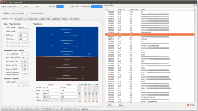

One thing that could help is that you can look at the CRTP sniffer in the client to see what the client is communicating. It can be displayed with view/toolboxes/crtp sniffer: This way you can see how the client is handling the setup sequence. In the tab LogBlock you can see the ID and variables of the block that are breing setup. One tip about this toolbox: disable sniffing just after connection in order to not slow down the full interface.
