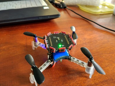

Re: How to get the quadcopter avoid obstacle with a sensor?
This is the deck I made using 13 ToF sensors.
