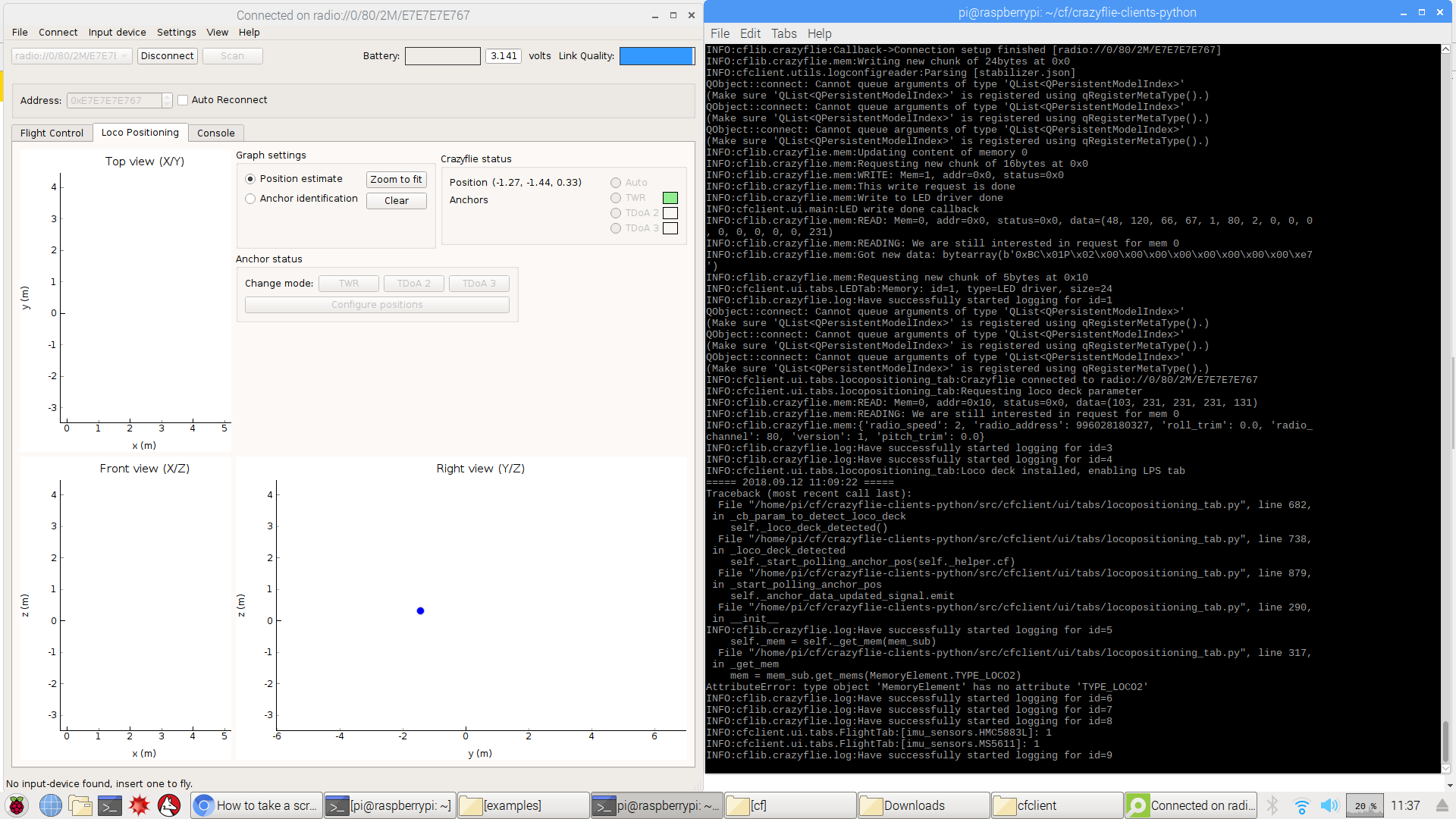

Can anyone help me out, I have my loco positioning set up but the configuration buttons are greyed out. Thanks.

I am having the same issue too. on both windows and ubuntu 18.04 LTS. Try getting an older version if you are using TWR and TDoA?
Re: Cfclient and loco positioning greyed out
It looks like you are running the latest client from git with the lib from pypi, it is currently required to use both lib and client from git (I think there is a way to add a git repos as pip dependencies, maybe we should do that during development).
If it is the problem you can fix it by uninstalling the pypi version and installing the git version:
cd <your dev folder>
pip3 uninstall cflib
git clone https://github.com/bitcraze/crazyflie-lib-python
pip3 install -e crazyflie-lib-python
