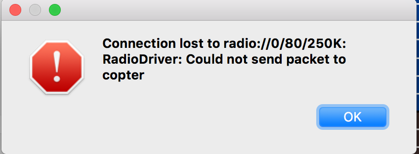

- I noticed that when I put the Crazyflie just one meter behind me, it becomes invisible to the crazyradio. (I don't see radio://0/80/250K on cfclient). The cf has to be really close to my laptop to be detected.
- The cfclient shows the following for the channel/datarate: radio://0/80/250K

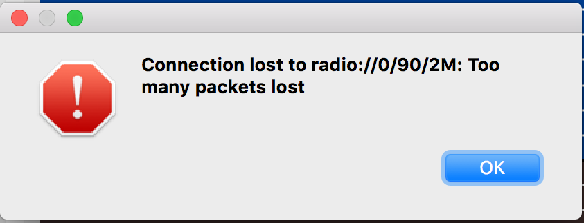

Try to change the channel en rate to e.g. channel 90 and 2Mbit datarate.
						Re: crazyradio disconnect over 1 meter away
Thanks Tobias for the suggestion. I have tried multiple configurations of channels and data rate and I have the same error message when sitting on my desk and just waiving the cf around me.
-I feel the problem is with the crazyradio but I don't know what other things I can check? any idea? is it possible that the crazyradio is defectuous? is there any other way to test the crazyradio.
