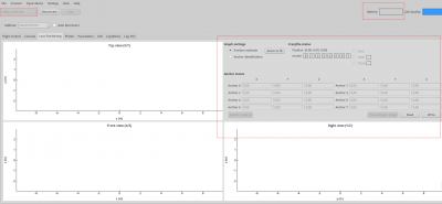

Why does the client have no location data?

loco positioning No data displayed

The LPS tab is detecting the LPS deck presence from the deck memory presence, since your deck does not have a programmed memory it is not detected. You can force the tab to enable by changing this line: https://github.com/bitcraze/crazyflie-c ... #L662-L663
Ideally we should check deck presence using parameters which allows to check forced driver. Apparently the LPS deck enable parameter has already been added, if you want to add a check of the parameter to the tab detection a pull request is welcome
