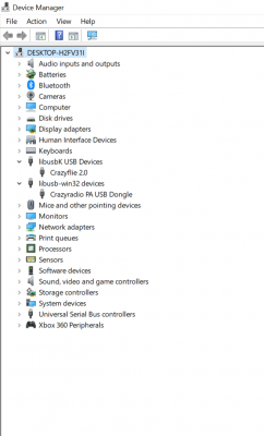

(1) I tried with both Crazyradio PA drivers - libusb-win32 (v.1.2.6.0) and libusbK (v.3.0.7.0). In both cases, I am able to see Crazyradio PA USB dongle in windows device manager.

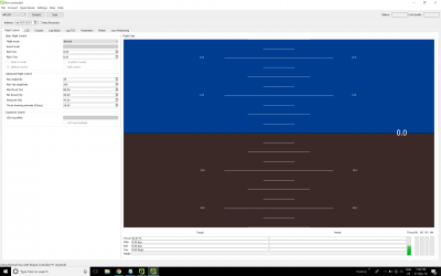

(6) I can see the drone on the PC the client, only if it is connected over USB.
