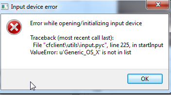

Hi im a newbee here, and have managed to do something with the client software.
The problem now is that its no longer recognizing my joystick .
I bleive i was playing with the mapping option and pressed Load something.
But after this i have tried almost everything without luck..
I havve uninstalled , reinstalled , cleand registry and so on ..
By the way my crazy flie works fine on a diffrant computer..
Any body seen this before?

Re: Cleint software and inputdevice
Check out the forum, to handle your situation:
The error referring to a bug in the client, see wiki for the problem,
"Please note!! In the 2013.4.1 and previous versions there's a bug where the loading of a previous configuration will not work correctly. The values are not loaded but the configuration call still be saved. This results in a configuration file that will not work and an error will be shown when trying to use it. In order to fix this manually delete the contents of the user config folder (win: C:\Users\your_user\AppData\Roaming\cfclient, linux: ~/.config/cfclient) and create a new configuration from scratch as described above"
So you need to delete the user config folder, before you can continue. If you want to use your own button configuration check out this forum:
http://forum.bitcraze.se/viewtopic.php?f=11&t=240 thanks to pHysiX
Greets, Redouan
Greets, Redouan

Thank you this solved the problem ..
