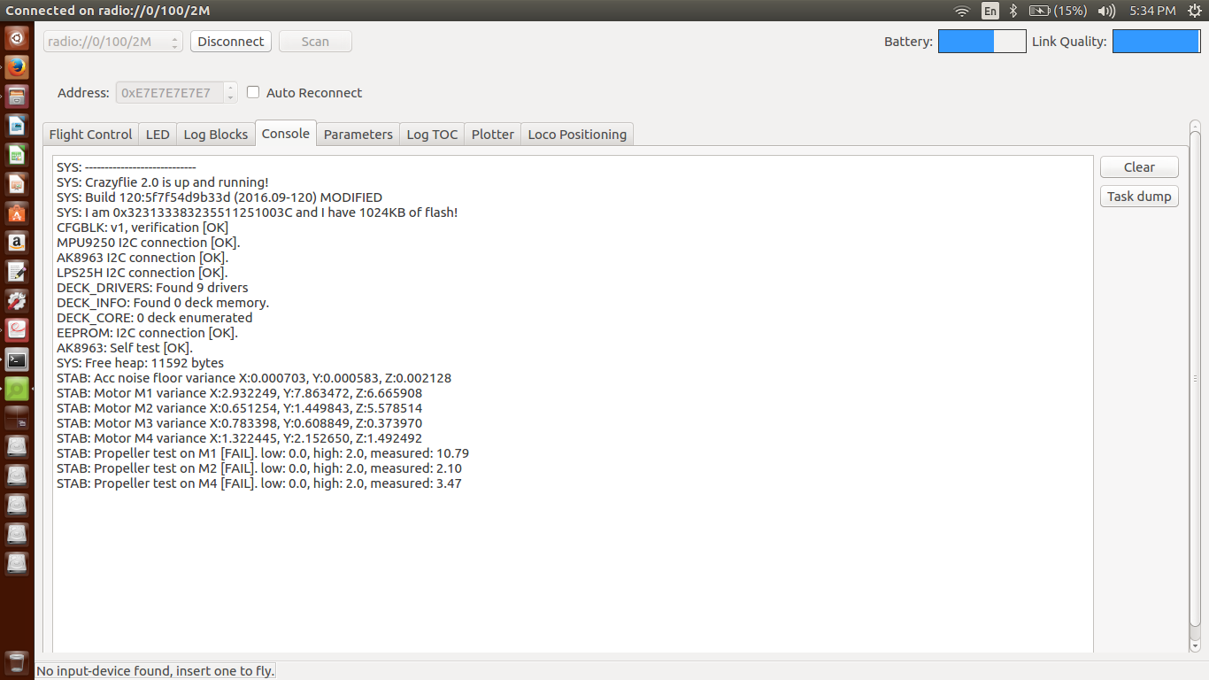

When connected to the BitCraze client, it reports around +/-0,3 in Pitch and Roll which I think is normal, so I'm really without a clue of what to do next
