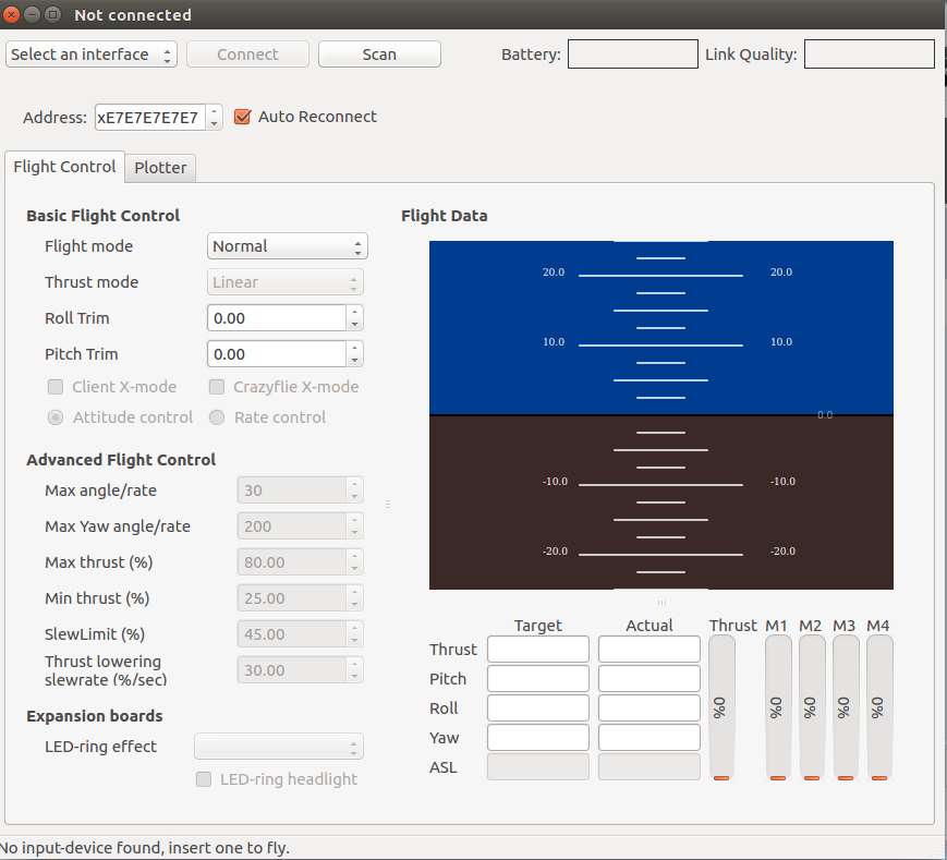

Hi Arnaud
When I power on the crazyflie, LED on M1 keep blink in red.
After start client, it still cannot found devices. The log showed on terminal is showed as below,
xiaohao@go:~/bitcraze/crazyswarm/crazyflie-clients-python$ python3 bin/cfclient
INFO:cfclient.gui:Disabling STL printouts
INFO:cfclient.utils.input.inputreaders:Found readers: ['pysdl2', 'linuxjsdev']
INFO:cfclient.utils.input.inputreaders:Could not initialize [pysdl2]: No SDL2 support on Linux
INFO:cfclient.utils.input.inputreaders:Successfully initialized [linuxjsdev]
INFO:cfclient.utils.input.inputinterfaces:Found interfaces: ['leapmotion', 'zmqpull', 'wiimote']
INFO:cfclient.utils.input.inputinterfaces:Could not initialize [leapmotion]: Leap Motion library probably not installed (No module named 'leapsdk')
INFO:cfclient.utils.config:Dist config read from /home/xiaohao/bitcraze/crazyswarm/crazyflie-clients-python/src/cfclient/configs/config.json
INFO:cfclient.utils.config:Config file read from [/home/xiaohao/.config/cfclient/config.json]
INFO:cfclient.utils.input.inputinterfaces:Could not initialize [zmqpull]: ZMQ input disabled in config file
INFO:cfclient.utils.input.inputinterfaces:Could not initialize [wiimote]: Missing cwiid (wiimote) driver No module named 'cwiid'
INFO:cfclient.utils.zmq_param:Biding ZMQ for parameters at tcp://*:1213
INFO:cfclient.utils.zmq_led_driver:Biding ZMQ for LED driverat tcp://*:1214
INFO:cfclient.utils.input:Using device blacklist [(VirtualBox|VMware)]
INFO:cfclient.ui.main:Auto reconnect enabled: True
INFO:cflib.crtp.radiodriver:v99.55 dongle with serial N/A found
WARNING:cfclient.ui.main:Exception while opening tabs ['Loco Positioning']
INFO:cflib.drivers.cfusb:Looking for devices....

It looks like I didn't set crazyflie address correctly.
I checked drone address over usb cable and set the adress to client software. It now can connect to crazyflie !
Just thinking it might be better to have a function to scan drone address automatic.
Thanks
