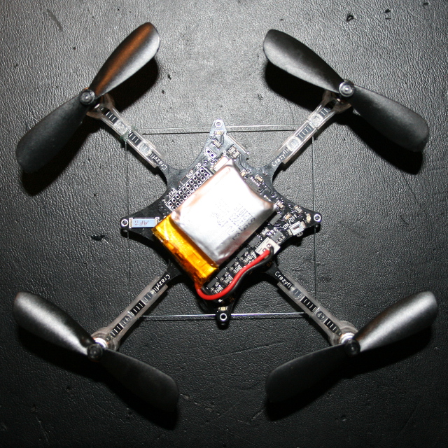

In another thread Tobias mentions using fishing line. I'd suggest simply wrapping the arm in a layer of fishing line. A thin coating of CA (Super/Crazy glue) and then a crash would destroy the sensors, props, motors and what you hit before the arms break. I think? :?
Re: reinforcing the arms
I was actually thinking of something similar to the attached picture. It will prevent the PCB arms from bending to much to the sides during side impacts. The fishing line still allows some flexing which is good as well. The fishing line could be tied around the motor mounts as well which might be easier to do. I haven't tested/verified it yet but at least in my head it should work :D.
Frame strengthen by fishing line.JPG (305.76 KiB) Viewed 8836 times
