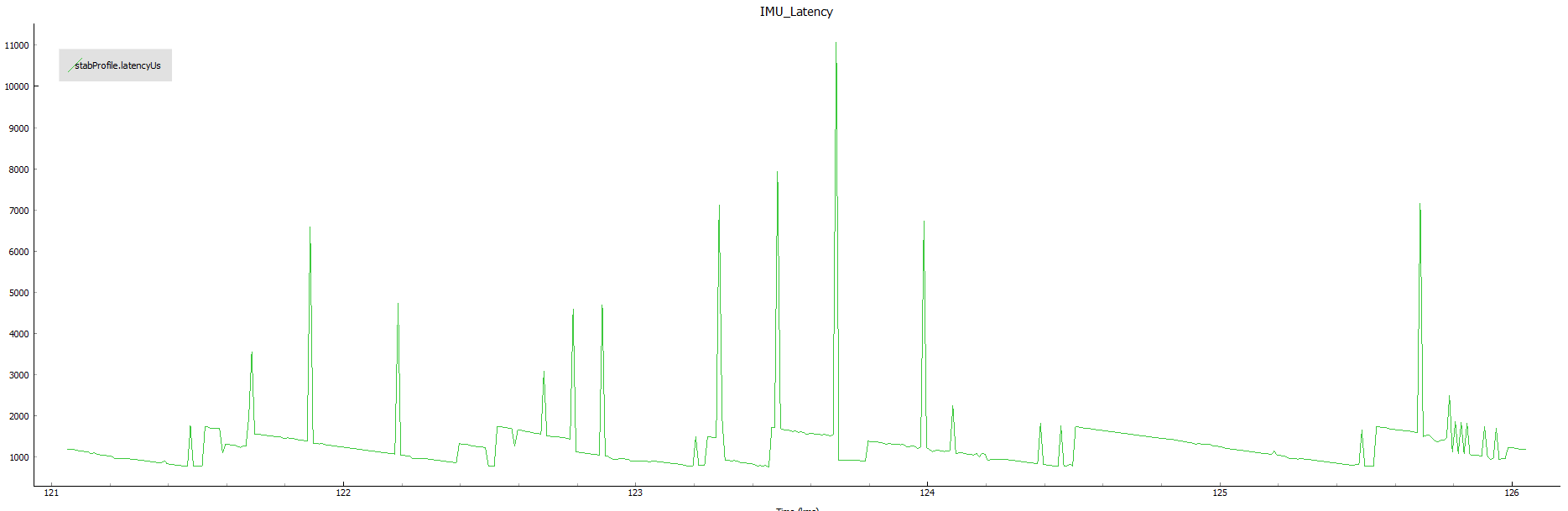

I haven't done a whole lot with this effort in a while now -- I got a bit sidetracked getting betaflight and cleanflight running on the quad, and then some other life stuff took up most of my time for a while. But I'm back now, and ready to dive back in to improving performance and stability.
I'm going to first focus on E2E latency between the IMU and the motor output, since the more that can be minmized, the tighter the PID loop can be tuned. I took a first pass at measuring the latency between when the IMU data is read over I2C to when the motor outputs are set. The results are interesting:
I think that the spikes and the non-constant latency would produce some weird behavior out of the PID loop, and should be addressed before attempting to reduce overall latency. In other words, I think a constant, higher latency is better than a fluctuating lower latency.
I believe the constant downward trend from 2ms to 1ms is due to the fact that the sensors loop is not directly synchronized to the stabilizer loop, and they drift over time.
I suspect the high spikes are a pre-emption thing -- for example, the task priorities for the stabilizer and sensors tasks are both set to 4, but the syslink task is set to 5. That means syslink data can pre-empt the stabilization of the crazyflie.
I'll try out some changes to test these ideas and report back!

Post by tobias » Fri Jul 07, 2017 7:55 am
That is not good for stabilization at all, good find!
The intent has always been to have the stabilizer the highest priority but I found this commit which increases the syslink prio. To fix the issue I think we need to implement DMA for the syslink uart rx. I will add a github ticket for that.
