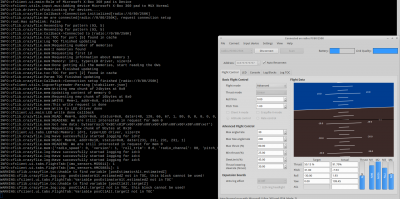

Got my CrazyFlie 2.0 a few days ago, and so far all I can manage to make it do is take a short hop and flip over in the direction of M4.
As seen in the screenshot, it appears to be overdriving motor M2 and underdriving M4. This behavior occurs whether I pin the copter to a table, or hold it in my hand at various angles. I've tried shifting the battery around, to no effect.

If you let the Crazyflie still on the table does the "actual" yaw moves a lot or does it stays pretty stable?
Interesting.
First startup, on table: Actual Yaw value seems to decrease continuously at a constant rate of .2-.3 degrees per second (significant)
Second startup, on sofa cushion: Actual Yaw increases continuously by about 0.03 degrees per second (small but real)
Third startup, on a different table: Actual Yaw decreases continuously by about .5 degrees per minute (small but real)
By contrast, the pitch and roll numbers are very stable, sometimes not changing at all, sometimes varying by ~0.02 degrees around a median value.
Posts: 2538
Re: M2 overdrive/M4 underdrive problem
Post by arnaud »
Hi, This is expected and normal: the gyroscopes will drift but pitch and roll can also be measured by the accelerometer that is used to cancel the gyro drift. YAW being around the gravity acceleration it cannot be measured that way and we have no way to cancel the drift. We had a bug in the gyro bias estimation that creates the kind of behavior you are observing that sometime the drift is much higher than others. This has been fixed in git.
Anyway this cannot explain the rapid rotation you are experiencing since these drift are pretty small.
Would it help if you set the yaw rate to 0 in the client (to make sure there is nothing wrong with the control)? And have you tried to update your Crazyflie to a newer firmware version?
